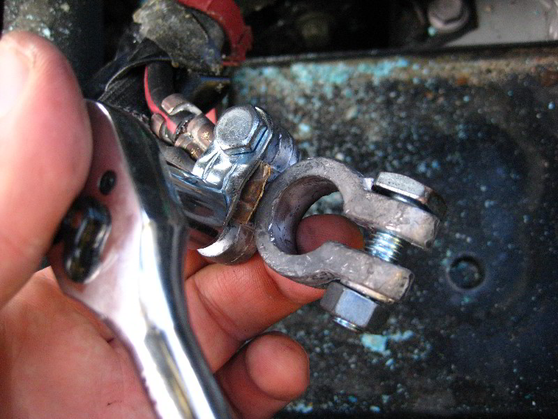

For the sake of a couple dollars for a real cable lug and taking the cable down to a local electrical supplier which will have a set of real crimpers I cant see why you would bother taking short cuts
It's like the soldering battery cable repair kits. Drop the plug into the terminal, heat it up, dunk the bare wire end in it's done all the time.

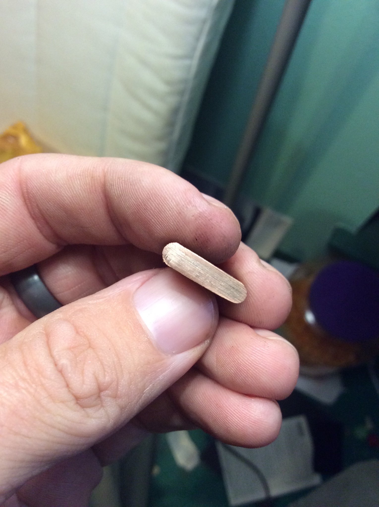

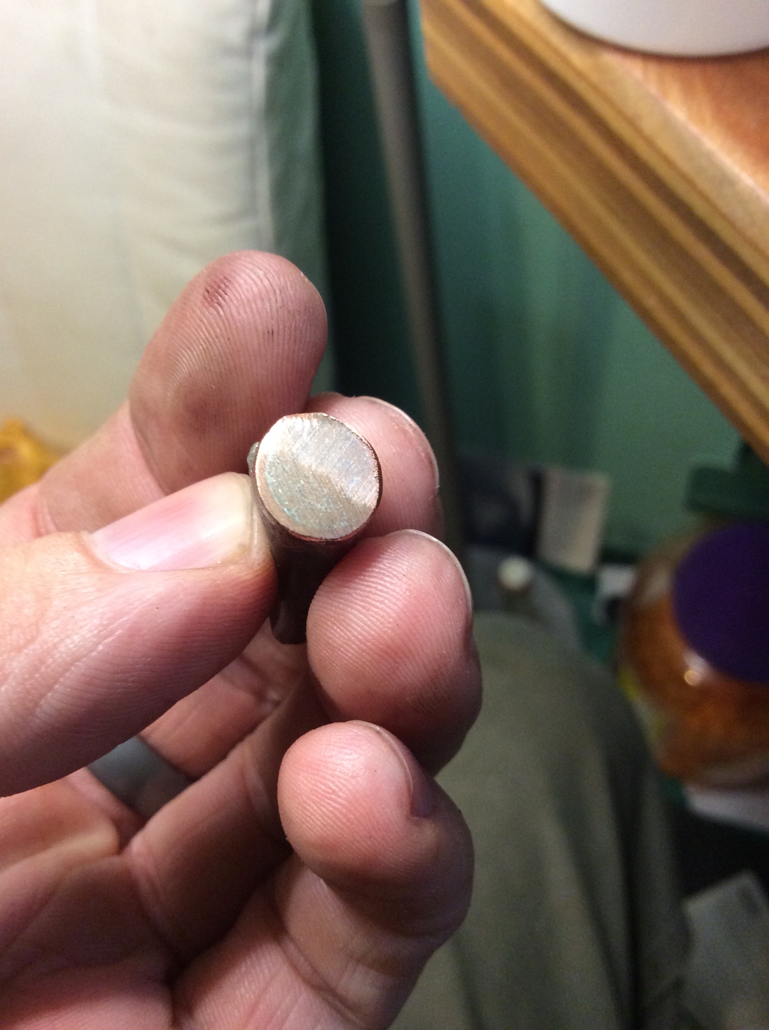

Either way, I cut that connection apart and am looking for the individual strands with space between them.
At the fat bit.
And the hammered to hell tab, barely any solder to be found in there. Maybe someone could point out the spaces between the wires for me.

For the most part just made it harder to hammer down though and didn't feed as snugly, though perhaps it would reflow nicely when it's heated back up to solder it in the terminal itself. I was pleasantly surprised with the cross section cuts on this especially the smashed down end, it got that stuff together tight, and in the nonflattened part you can make out where the solder filled any voids.

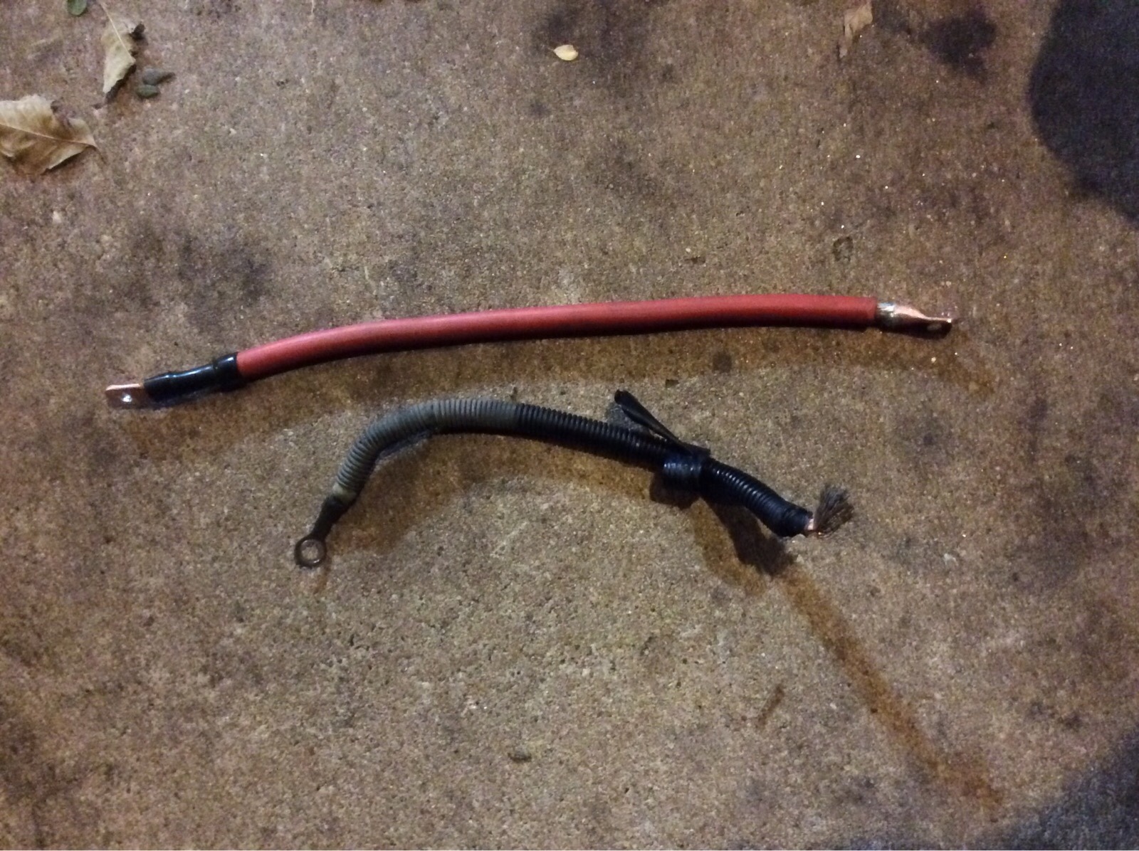

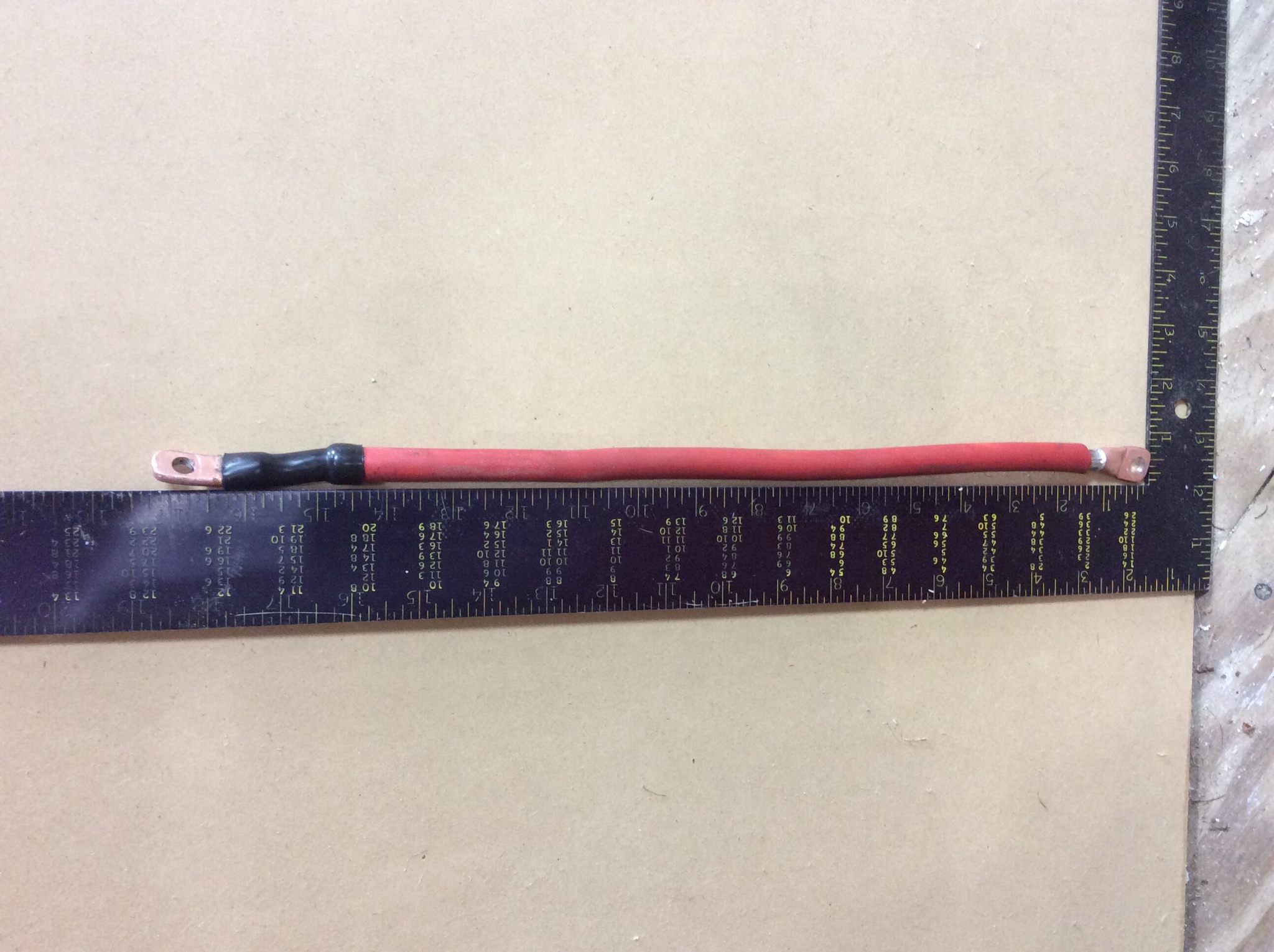

Battery to starter 17"
Comparison to original. A little extra length is needed as the heavier gauge wire isn't as flexible.
Also I ran out of heat shrink for one end but I'll sort that tomorrow.
