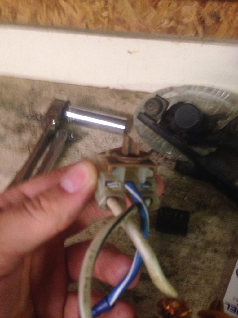

  • Now the question is, will one out of a manual wagon work? My car started off as an automatic.
  • NZ-DB8RNZ-DB8R Moderator
    Depends what it is, obviously a plug but which one?
  • Ignition switch
  • klumklum Senior Wagonist
    any one from the same year will work forsure except 88 not forsure about that try to get one that matches ur year , sedan, hatch, will work
