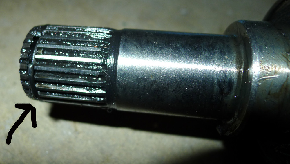

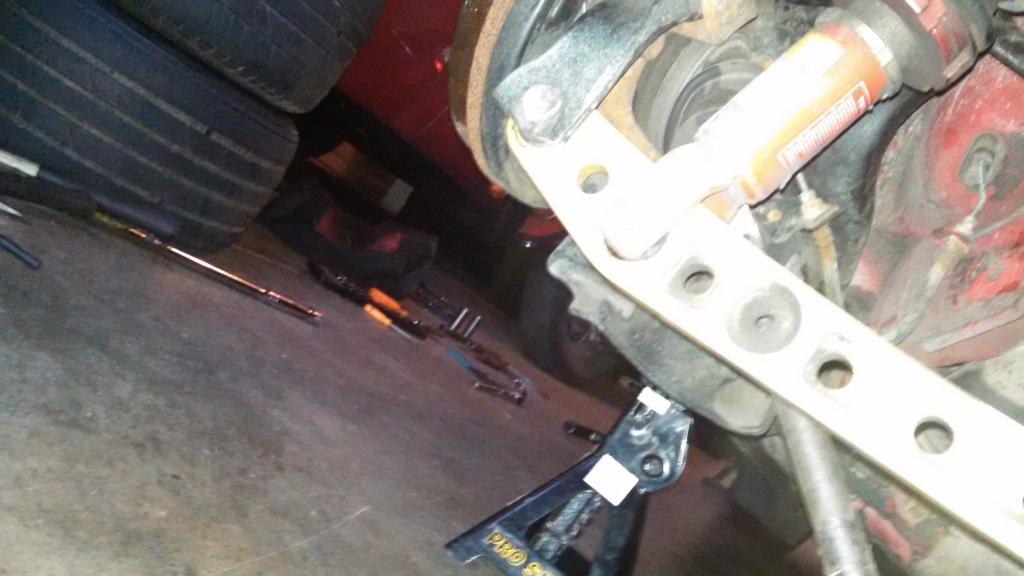

These are the rear ones... I have them hanging at the moment bc I cannot remove them from the trailing arm
I tried hammering the axle but it doesn't move, I was reading online and theres people that say they need to be pressed out or something like that, but this does not make sense because this would not be practical.
Does any one know if the axle can just be hammered out or do I have to press them out?
I don't want to continue hammering if the axle needs to be pressed out, if this is the case I think I can just remove the boot and pull the axle out without removing the outer cv part of the axle. I can just leave the outer part of the axle on the trailing arm.
What do you guys suggest I do?

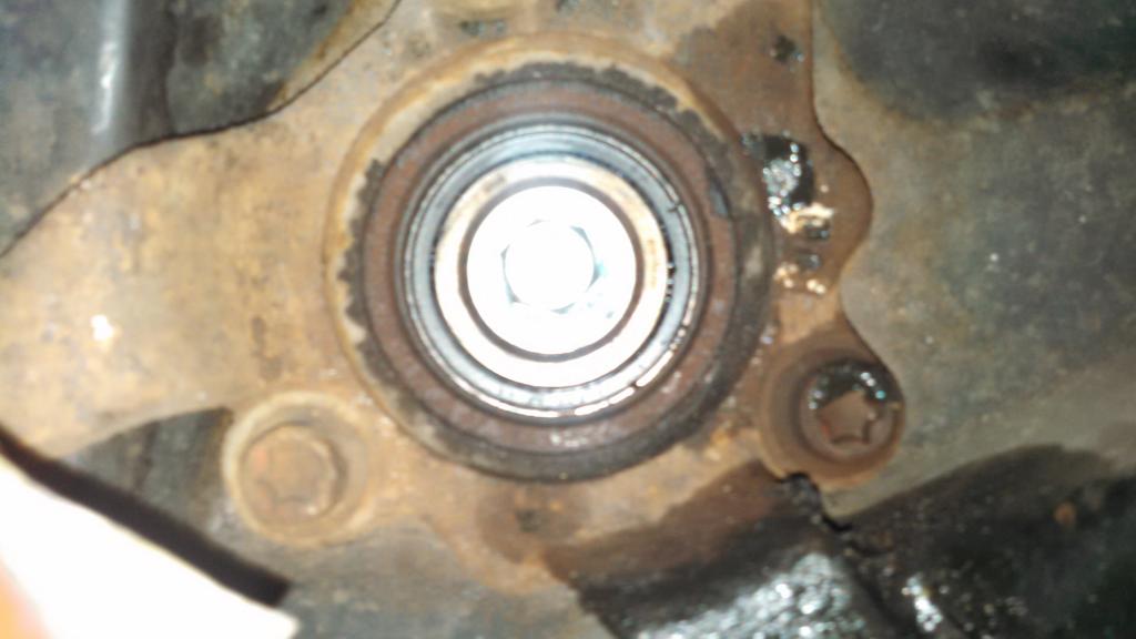

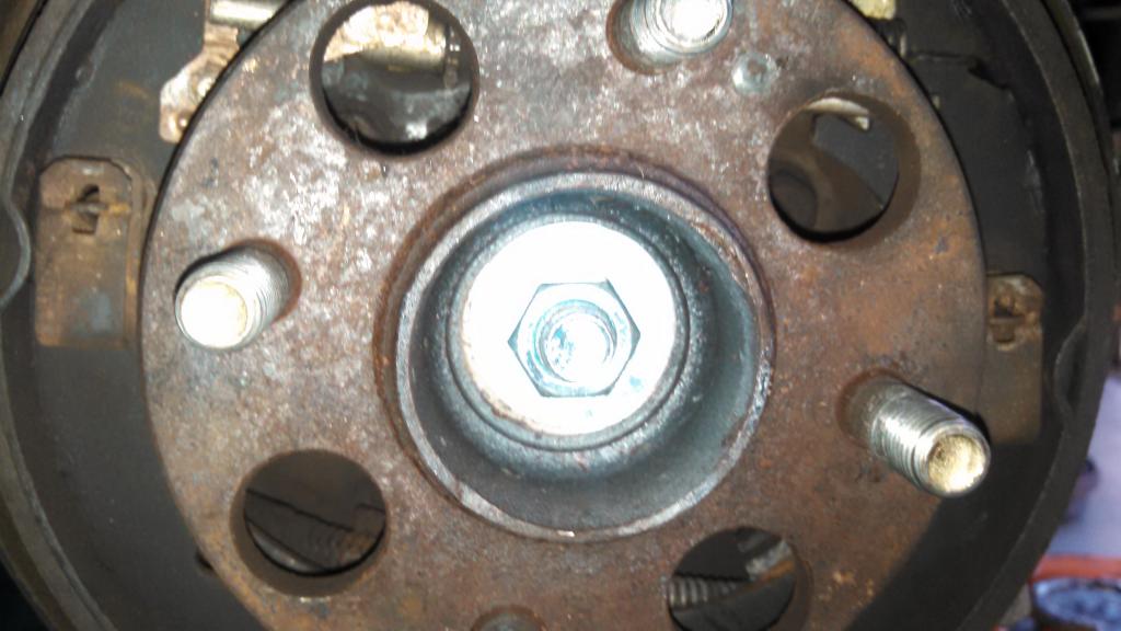

So what I did after it was too late was I bought a bolt, two washers and nut to simulate a axle and nut in the rear hub. Meaning that the bolt and the two washers help sandwich the hub and wheel bearing.
Has anyone had this problem with the rear wheel bearings going out after removing the 4wd system and leaving the rear hub open like I did in the beginning?

So after removing the rear diff and axles my rear wheel bearings gave out. There is a lot of play. Do all civic wagon rear bearings the same or do I have to get rt4wd. Does anyone have a part number for it? Also to avoid from future rear wheel bearings going out what do you guys do when the rear axles are remove from the hub? ( I remove the 4wd system because of bad u-joint) I tried using a bolt and washers to hold the hub and wheel bearing in place but did not help, any recommendations?
To remove the rear wheel bearing from my rt wagon I must get it press out right? Has anyone done a rear wheel bearing on a rt model wagon? any suggestions?

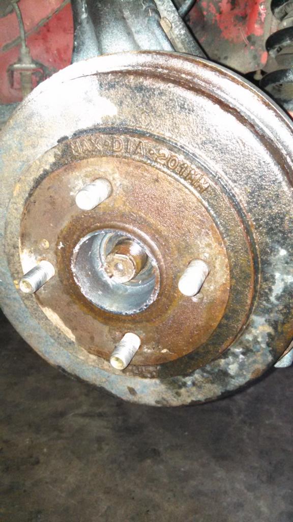

I found the problem to be a worn out u-joint. I was able to take my axles of and everything. The problem now is that My rear wheel bearings went out causing the rear hub to move dangerously. If you look at the two videos I posted the bearings sound nasty and the moves a lot. It has play in the hub.
I want to know if I need to replace just the bearing or hub and bearing? And do I have to get the bearing press out?
After replacing the bearing what are my options so that this doesn't happen again? I do not have the rear axles installed because I removed the 4wd system. This means I dont have the rear axle holding the hub and bearing in place. What do you guys recommend I do?
Yes, I believe the bearings would be best changed with a press.

That was the reason I tried using a nut, bolt, and washers.
Unfortunately I had to sell my wagon a month or two after replacing the bearings so im not sure how the replacements held but they are out there. You have to do some searching.
What do you guys recommend I use or do? Would a bolt, nut and two big washers work in place of the axles?
