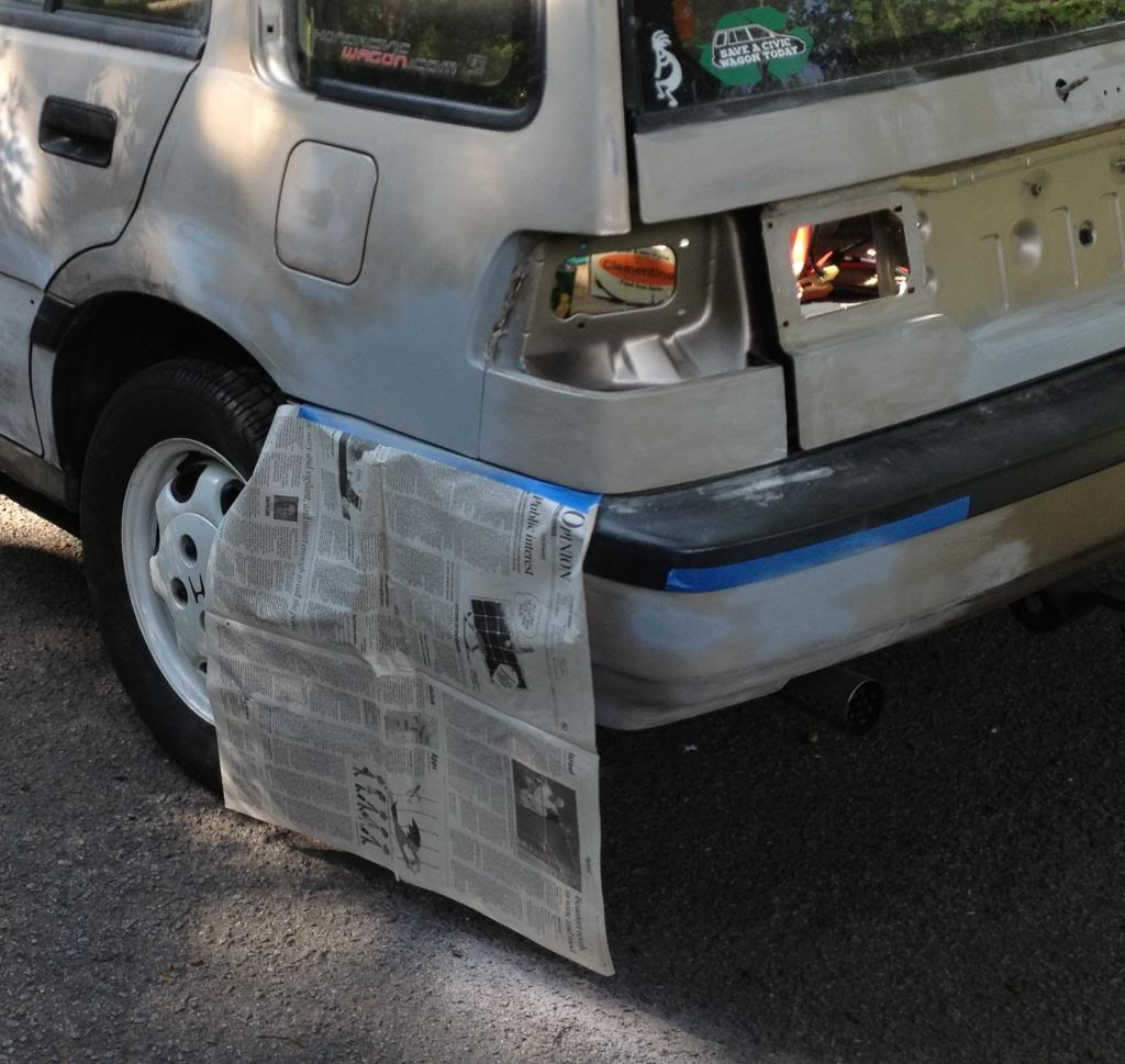

Fast forward to now. I am in the beginning stages of a respray on the wagon initially brought on by being tired of looking at this.
This is where the fun starts.

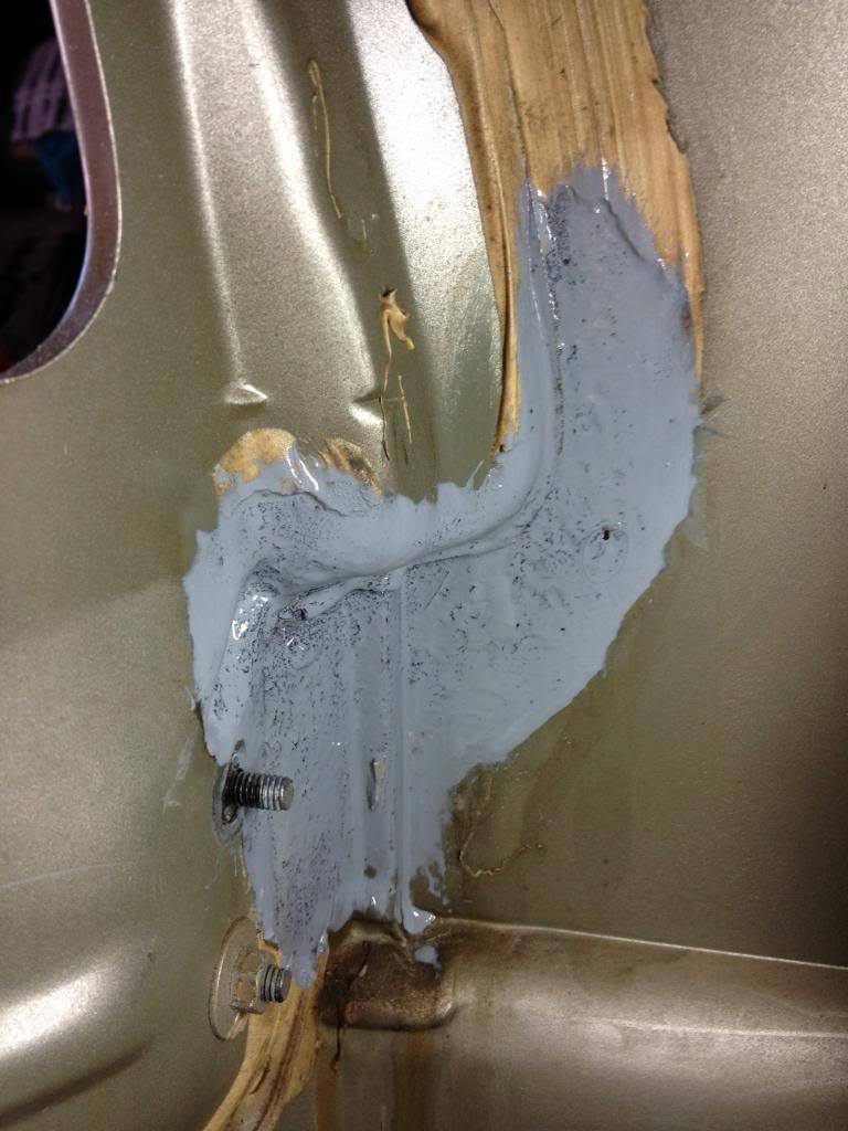

It comes in Black & Grey. I chose grey for no particular reason.
Man Was I impressed. I used on the driver's side that wasn't completely rotted out. The can says you can paint directly on the rust, but that didn't sit well with me.
I scraped away the seam sealer until I was out of the rust zone. Then I hit it with a wire brush to knock the crustys off.
After it was clean, I washed it down with acetone to clean up any residue. Then it was time for paint. Didn't know what to expect.
This stuff was very runny. It goes on super thin and runs down a vertical surface with ease. Non the less, I built it up with thin coats. Six in total.
When this stuff dries it is rock hard and super glossy. I am very pleased with the end result. I feel this corner will last forever!
I highly recommend this solution if you find inner rot in this area of your wagon that has not completely rusted through. Mine only had a pinhole rusted through.
The POR-15 filled in this pin hole and I was able to use body filler on the outside and you can't tell there was ever an issue!

I got a buddy to come over and weld up some patch panels I made up.
Fiberglass, putty, and a lot of sanding
Seam seal & POR 15 the patch.
Now we are ready for paint!
