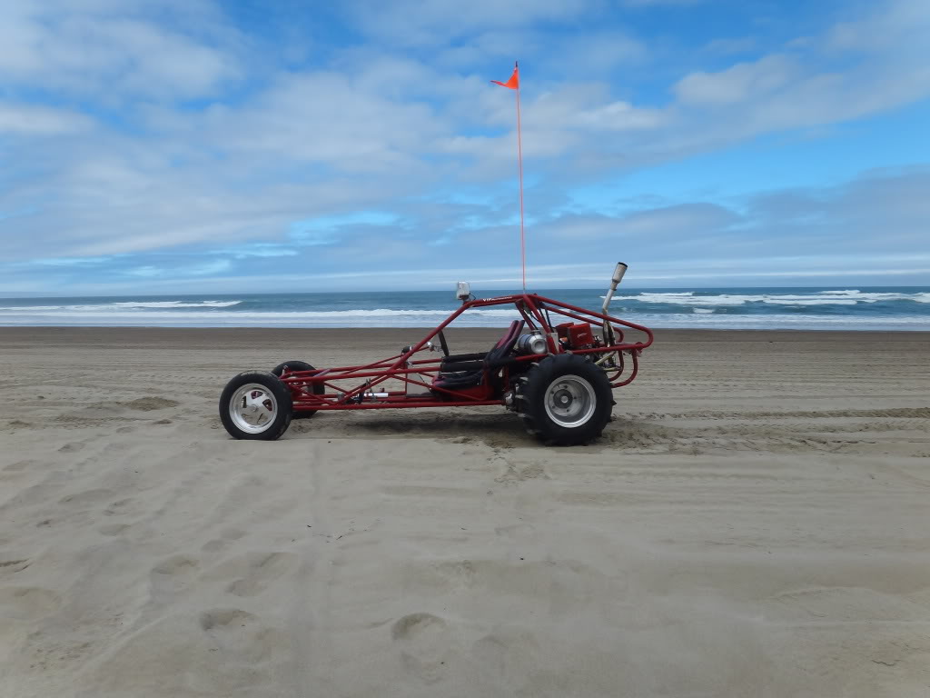

The first is a my sand rail, it was my dads old rail. when I was a kid he build it up in the garage. Last June my dad sold it to me after I nagged him about it for the last 5 years or so!! anyway I started off my getting the 2180cc air cooled vw engine back up and running nice and strong. I re-jeted the carbs and dyno tuned it. after a few trips out I remembered something, WHY I GOT OUT OF VW'S!! anyway a change of engine was needed. I made the choice to switch to a Honda power plant, the Acura 3.2 TL motor was the one!! Now the rail is a wheelie pulling monster!!
I used to be a VW nut as well. Rails, bugs, bajas, buses, even a Westy.
What transaxle are you using? I can't see enough detail to tell.
Funny you ask, I'm working that up right now!!
Its a 3rib bus transaxle, I dissasembled it and welded 3rd & 4th gears all stock other than that, I do have a clutch masters flow valve to reduce the shock of engagment. I use a redline oil too, I'm been out 5 times with the setup and its still holding up

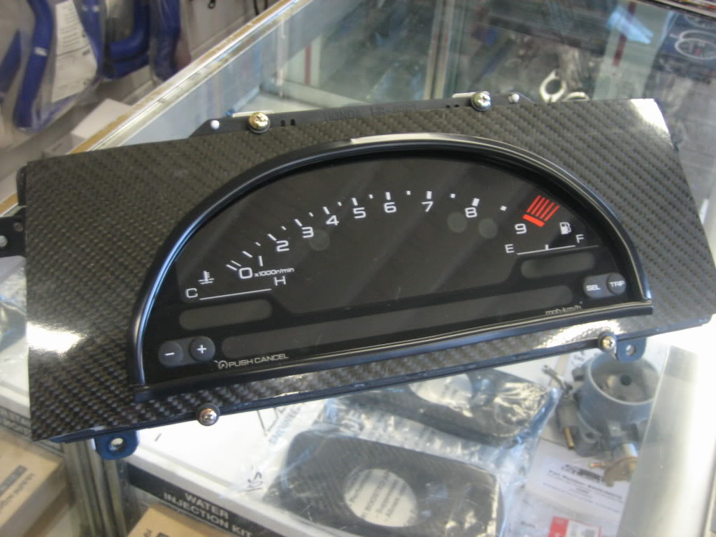

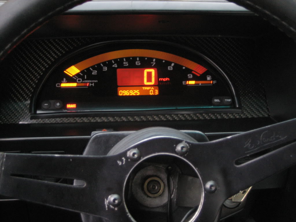

I custom fitted the S2000 cluster into the stock gauge cluster location's using existing factory gauge cluster parts
