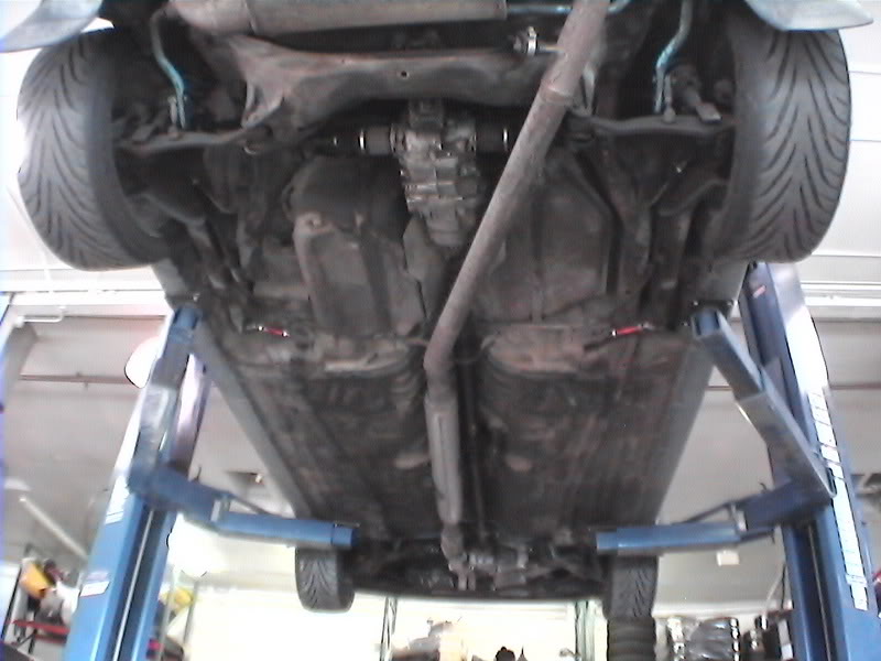

Heres a pic, not a good one, but you can see how I taped the rear LCA's.

Check the end link. It is istalled incorrectly. The bar end should be above the control arm and in a horizontal position. To accomplish this
may I suggest you look for a prelude si rear sway bar end link (will provide a photo later) and a .5" shim under the frame mount. The shim positions the center of the bar for adequate clearance and the link puts the end arm in the perfect position. Working on mine now and will provide pictures soon. 90-93 integra swaybar + same yr control arms (installed in the reverse postion to bring the mount tab to the rear of the car) + the links mentioned (to check reference). The set-up provides a pro job!!!!!

It is the end link that is installed upside down. The sway bar end should be positioned above the LCA. Just unbolt at the LCA and move the bar and install bolt. I do have the correct endlink for the perfect fitament.
Need to check the reference model and year--will do that this morning and get back with you. Believe me it puts your swaybar in the perfect position and looks stock.
