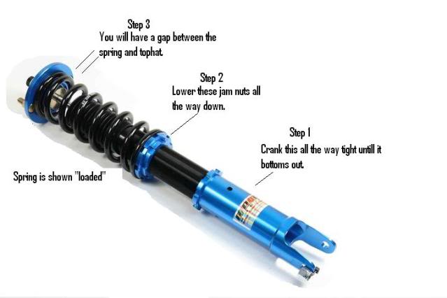

ok so i installed Megan coilovers today and well the back looks like its stock height =/ the sleeve is all the way threaded into the cup. any suggestions PLEASE. I might just cut the sleeve so it can be threaded further in. please help

  • Sounds like he has full coilovers. I assume you have the ride height adjusted all the way tight but still have the spring preloaded.
    You will just need to unload the spring by threading the nuts down, you will lose shock travel but it shouldn't be enough to damage the shock. If you already have them all the way down then you are screwed. Will need to find shorter springs or modify.
    EDIT:
    Look how damn nice I am, see below. Should help a little
  • Take the 2 lock rings out, Thats what i did with my megan's but i still have 12 threads to go of spring adjustment before i'm maxed out.
    Err, i guess they're called "jam nuts" But whatever!
    You can take the bottom mount completely off and unscrew the 2 "jam nuts" since you'll have the mount adjusted all the way up anyway.
    I'm stoked on the ride but not stoked on how low i can go once i decide to lower the back as far as i can.
