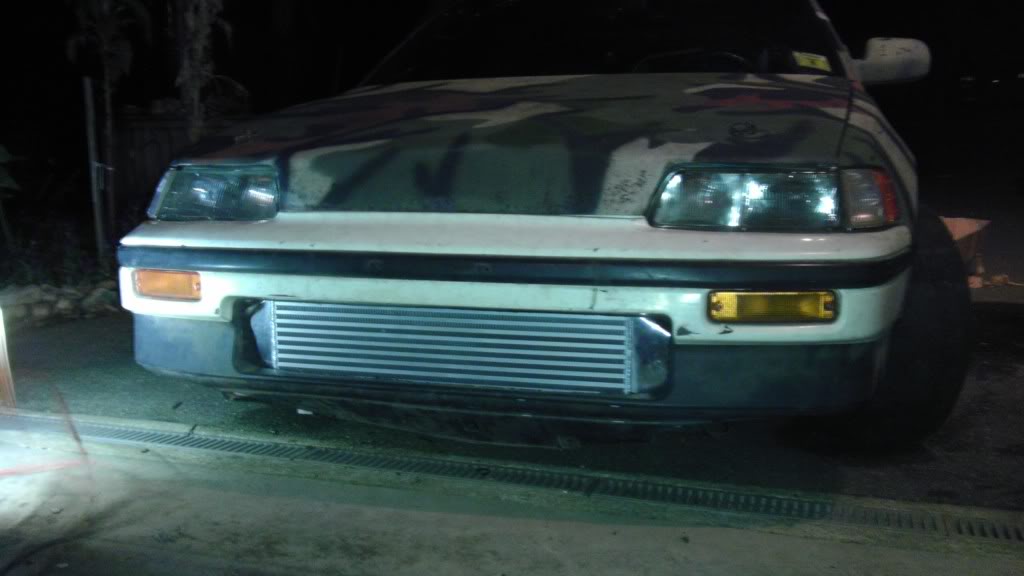

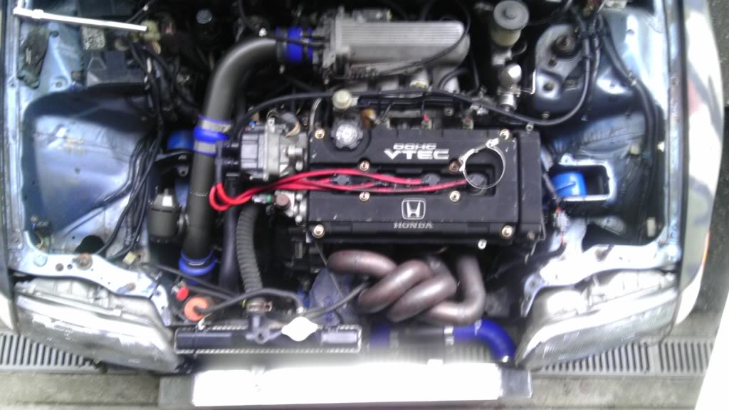

The one i'm running on my crx came from CXRacing and was originally meant as an upgrade for a 1G DSM. It does work perfectly for either 1/2 of full width radiators with minor trimming of the sheet metal on the inside of the frame rail. Mainly this is to clearance for the I/C piping and end-tank outlets. The bumper shell will always need to be trimmed, since any EF/EE/ED chassis is woefully lacking in vacant bumper space. I'll post a link to it as well and an on car shot. Keep in mind my build is pretty large so the radiator support has been removed and the hood is custom to hide everything. However the rest of the geometry in the front is stock, so this type setup is very workable on a more civilized setup.
Top-down. Forgive the glare, it's a cell camera.
Front-shot.
Money-shot, still needs paint.
