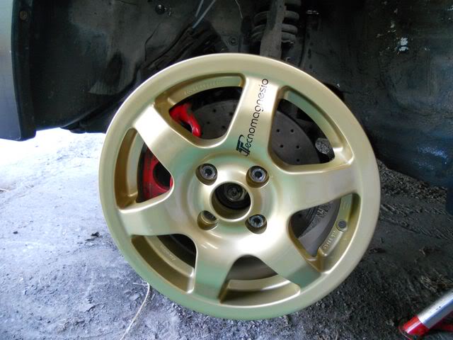

I would install new rims,14x6 ET38,and i've seen that the Muteki open lugs that i have are skrewed in studs only for 16mm...it's enough ?Have you had problems installing your rims with the stock studs?Thanx

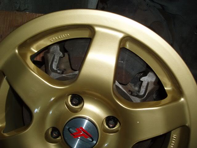

This pics is with the stock nuts used as teaser,but it's quite the same with Mutekis...
with Mutekis

If the lugnuts are skrewed enough in the studs or not

Hmm, maybe a bit short.
You may have to use something like these :
http://cgi.ebay.com/ebaymotors/ws/eBayI ... 0159986995
motorpunx
New Wagonist
August 2011
The Mutekis have already a conic shape for aftermarket wheels but i would know if the stock wagon studs are enough long also with aftermarket wheels
