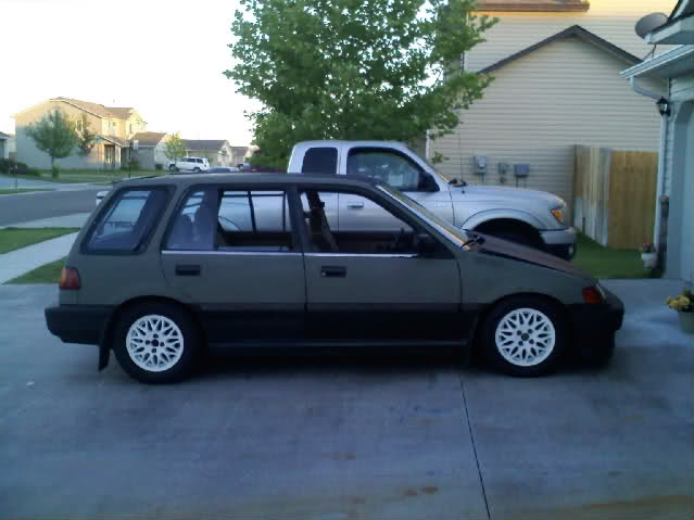

    Here is a picture of what mine looked like with the two tone look. Hope this helps.
  • dunndunndunndunn Band Wagon
    thanks=) did you paint the sides and bumpers in one ? or just soft black that looks like the bumpers? =)
    Painted everything with the same black. Had to my bumpers were faded bad when I bought it.

    first photoshoped then actualy did the 2tone paintjob, same reason, to cover areas that were rusty and dealt with and needed to be repainted over. heres a link to my build thread to see the photoshoping and then actual paintjob. hope it helps.
    viewtopic.php?f=5&t=12908
    heres a quick pic of it done too incase ur too lazy or busy to go through my thread.

    I did do it myself, to be honest, no primer, wasnt needed, never have needed it when i do this style paintjob (done my jeep, my brothers jeep, my friends ranger, my old civic hatch, and the wago) all done this way. masked, scuffed, final wiped, and sprayed with like 6 rattle cans of european texture undercoating (more fine textured) i know, i know it isnt the right way to do it, but hey for $60-$80 in materials and 2 hours from masking-sprayed and peeled, in my mind cant go wrong. did some rust repairs before I painted, grinded it out, used that rust converter stuff, then fiberglassed it back to its shape and went onto the paint process. spraying with this stuff is idiot proof since it is finely textured and fills in realy easy, also drys very fast. anyways so all of the vehilces i have done this way are still holding up fine to this day some of them were as long as 3-4 years ago, but it does fade to a more flat lighter black, which i dont mind, and im sure eventualy after pressure washing it for 4 years it will need a respray, luckily its only another $60 and 2 hours of my time to spruce it right back up. if your a perfectionist looking for a showroom finish obviously dont go this route, if you are like me and are on a budget and just want to spruce it up a little and hide the defects i think its a great way to do so. as long as you dont mind the slight fading, eventual need for a respray, and the fine textured look.
