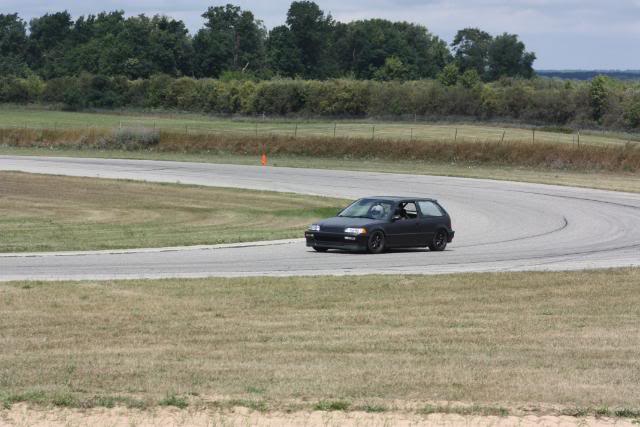

think I seen that SN some where before....Ef-h or H-t
Ugly Ed is the name of my track car.
more info on Ugly Ed??

here's a link to my old thread for Ugly Ed
http://honda-tech.com/showthread.php?t=2090611

that track in the pic is Gingerman raceway in MI.
there area a few other tracks in my area but I tend to have the most fun there.
