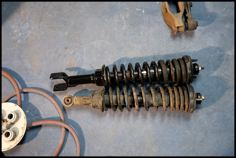

The shocks side by side Teg is on top Wagon is on the bottom. Note they are the exact same length

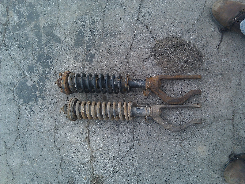

Integra on Top, RT on Bottom

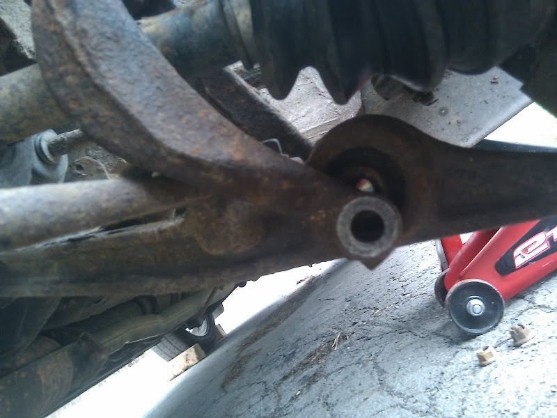

I was in a hurry to get it done so I could drive her to work today so I didn't spend a lot of time screwing around to try and get it crammed in there but I did give it a bit of an effort for the heck of it. Without completely tearing everything apart I couldn't figure out a way to make it work. I just couldn't push the LCA down far enough to get the bolt through. I also ran into some contact with the arm on the knuckle that goes up to the the UCA.
So I gave up for now and will be looking for something else to throw in the front to make it work. The guy I got my DC shocks and forks from also had a set of DA shocks I might have to check with him and see if they are any shorter.

2 words: Spring Compressor
or else you have to release either the UCA or LCA and the upper is easier and use your jack to get it back into place.

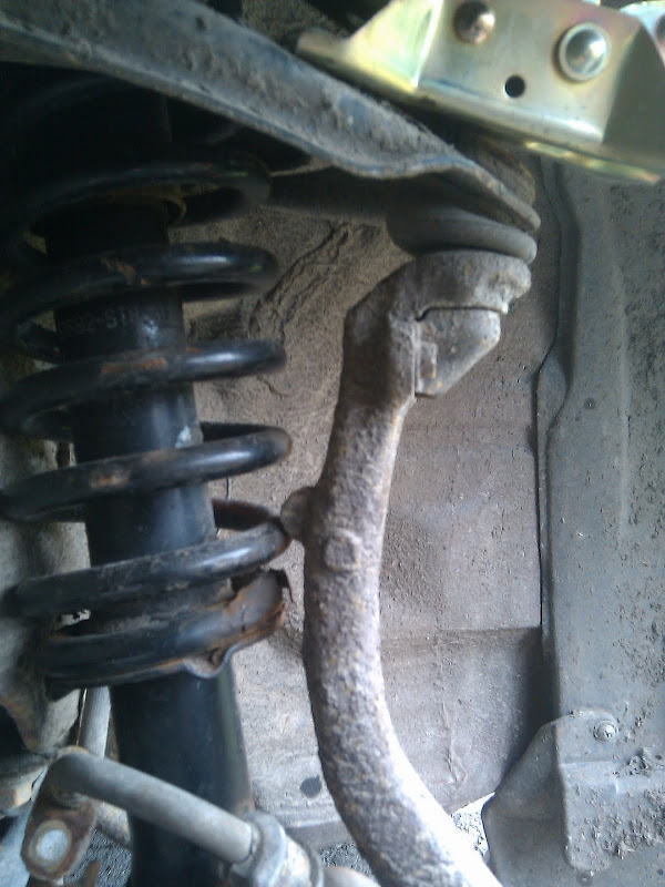

and if i were to cut off that nub shown here in the picture....the one touching the spring, would it clear the spring?
If it will i am going to pick some up tomorrow and try it...let me know what you think.
Yep, all 88 civics including wagons have the ITR style LCA's. 88's were their own beast in more than one way.
Id have no problem cutting that little tab off either.
