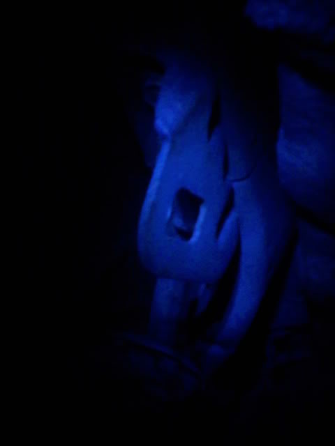

pics are first
cleaned up decent
i still need to clean the interior out better
just picked her up on the 16th, 251k.
