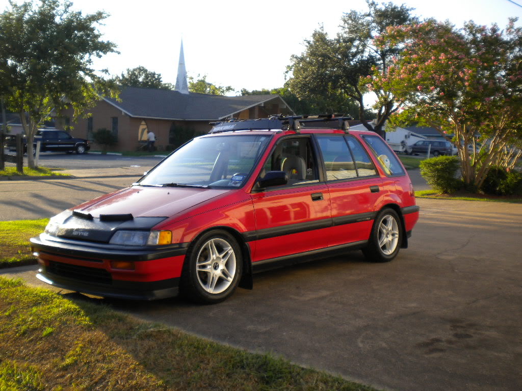

    I dunno man, it depends on how bad the paint is.
    You can see just how dull and lifeless my paint was here when I first got my car.
    You obviously wouldn't use a clay bar on paint like this.
    I used Meguiars Cleaner Wax first, then after removing a shitload of the crap that was embedded in the paint I washed it again and started applying a few coats of Meguiars NXT wax. here is how it looked after the wax.
    And this was just done with microfiber towels and alot of elbow grease.
    Post pics of your paint so we can see what you're working with.

    Meguiars makes a 3 step cleaner and wax. I used it on my Rio Red hatch and it worked really good. Its a lot of work though. Its like waxing the car 3 times. :shock:

    wow looks great 8)
    worth every moment

  • Lol...Jesse your car looked like you've had a flat red paint job!
    I'm just getting a respray sometime before winter, that's how I'm solving the problem. Show us some before and after once you get it done!
