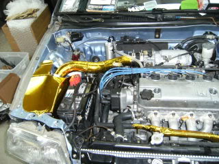

New SMSP 2.5" exhaust with 2.5" 300 cell high flow cat, 2.5"x 6" round Magnaflow muffler in the tunnel and 2.5" in two 2" out oval Magnaflow muffler. Also put on an old DC Sports try-y header with custom secondaries and 2.5" collector.
Santa brought me some Ate rotors, Hawk hps pads, and Satisfied shoes. I have Russel braided lines too.

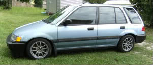

    So here is the car now. Got some Tokico Blues, GroundControl coilovers, and tophats. Also got the TR Motorsports wheels.
    FastBrakes 11" front upgrade.

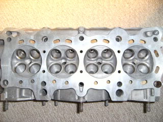

    I have been building a d16a6 for the car and I finally go it in.

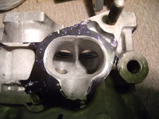

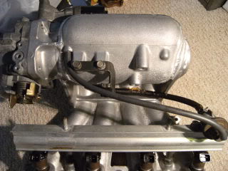

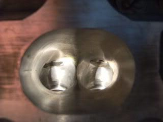

    D16a6, 75.5 pm6 pistons, block decked for zero deck height, ported head with Supertech valves and springs, Y8 intake manifold (cut open and ported), Web Camshafts grind, balanced and blueprinted, Arp rod bolts, and an Exedy lightweight flywheel.
    The trans is the stock Dx with new brass, bearings, seals, and an MFactory 4.70 finaldrive. I also did a mild wiretuck, and converted it to obd-1. Im running a p06 with Neptune RTP.
