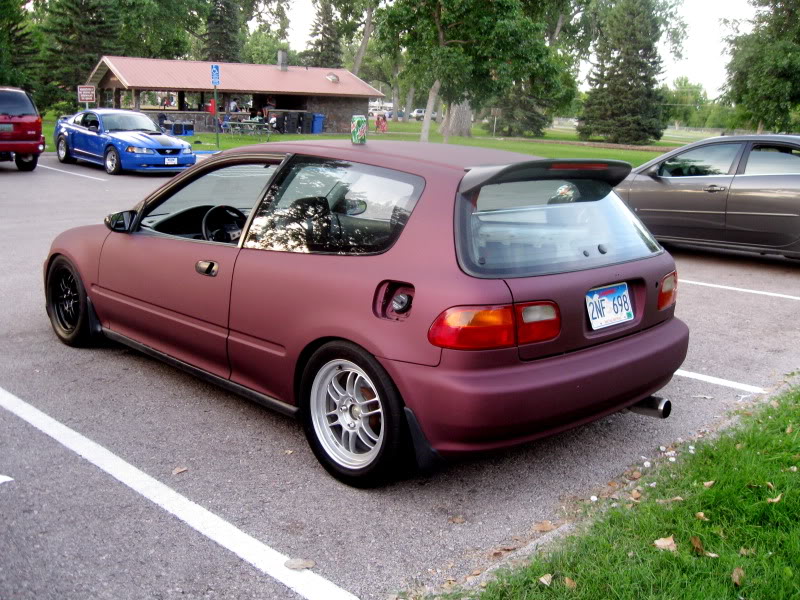

similar to this but orange
this guy says he used hot rod flatz, vintage burgundy pearl from here
http://outboundlink.us/anxo/dr_ta_1/got ... flatz.aspx
theres a copper orange pearl listed on that site but i want something brighter than that.
