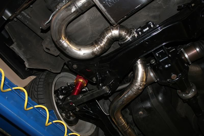

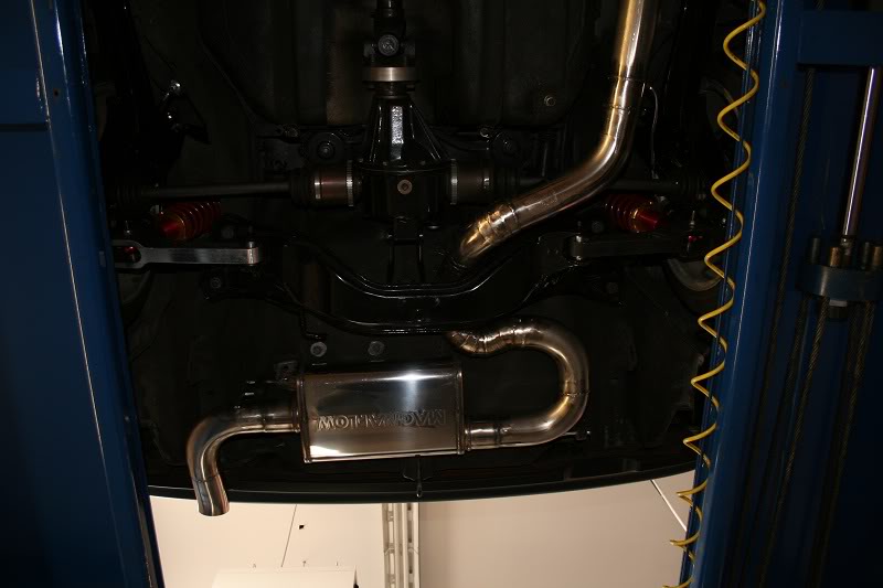

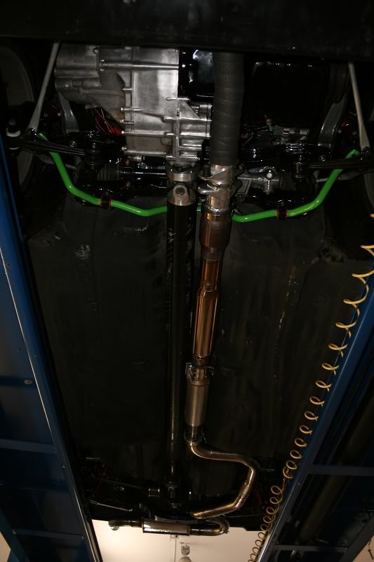

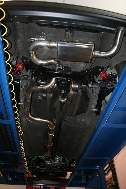

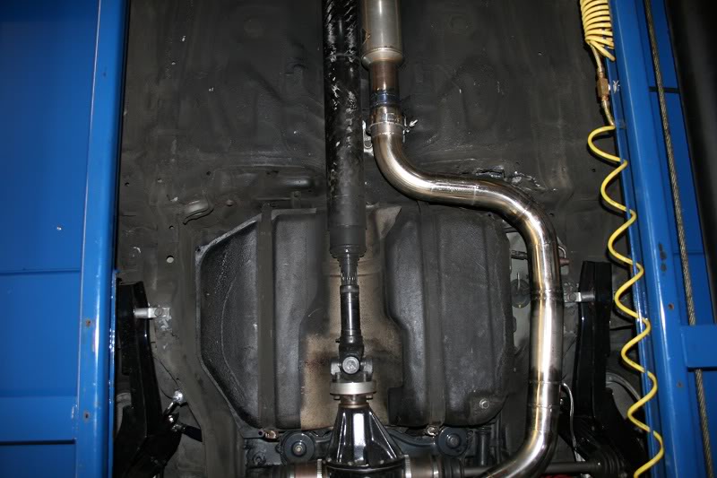

    HKS exhaust modded to fit wagon. Expensive option, but looks great like stock but better.
  • 503Wagon503Wagon moderator
  • 503 Your setup is beautiful! Did you build that yourself, or have a shop do it? I imagine a shop would charge quite the penny for something like that. Looks like a LOT of cutting/welding!
  • EDIT: Is that Jaker's car? I thought the exhaust looked familiar.
    That's Jakers old setup on his RWD wagon, I saved the pictures because I want to do it to Jane once I finish up the turbo setup.
  • Lol, I thought so. As soon as somebody said Jaker earlier, that's the setup I remembered in my head, and for a second you had me thinking I had his mixed up with someone else's.
    I'd like to have something like that if the shop won't charge me out the ass for it. I just like how neatly its tucked up under the car, lots of clearance.
    Damn I wish I knew how to weld, and had the equipment to fabricate my own setup!
  • Jaker's is definitely a tight setup and far from being cheap. I fabbed my own but didn't have it in me to do all the pie cuts and welding he did to tuck it so being a lazy ass I ran mine as close to stock as possible. Mine alone with just material was roughly 400. Lots and lots of hours to make everything straight and level as well.
    I don't know why I need to scrape the Honda off but will do boss! It is too bad about Jaker's wagon by far one of the meanest looking wagons on here.

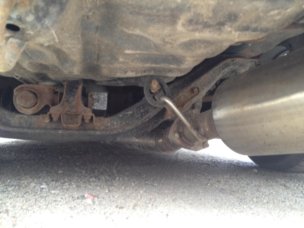

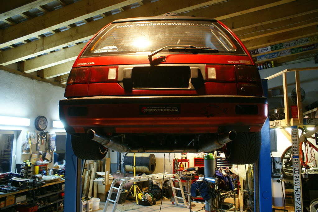

    This is my exhaust, for now pretty loud, but with right muffler right what I want! This will be good for turbo, as straight as possible:cool:
    Now I have changed muffler and putted it more outside the rear bumper, but still it is like JDM style (not straight)

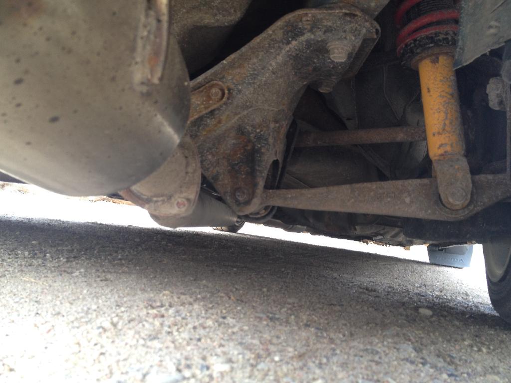

  • I like this setup, very simple, not too many bends. How is ground clearance? Your wagon looks pretty low, does the exhaust scrape on speed bumps?

    Clearence is very good, speed bumps are no problem! I will try to take a picture and upload it today ;)
    Yeah, didn't notice about the sway bar.. But I think the rear sway bar on this 4wd system won't make a big difference, because that rear mount is pretty massive itself! It's not like all FWD hondas where the lower arm mounts are melted to chassis..
  • snowbrdsnowbrd Wagonist
    So here are some pics, lowest place is so high that I can put a iphone sideways below it. And that place is on the rear wheel axis and won't scratch on any speed bump.
